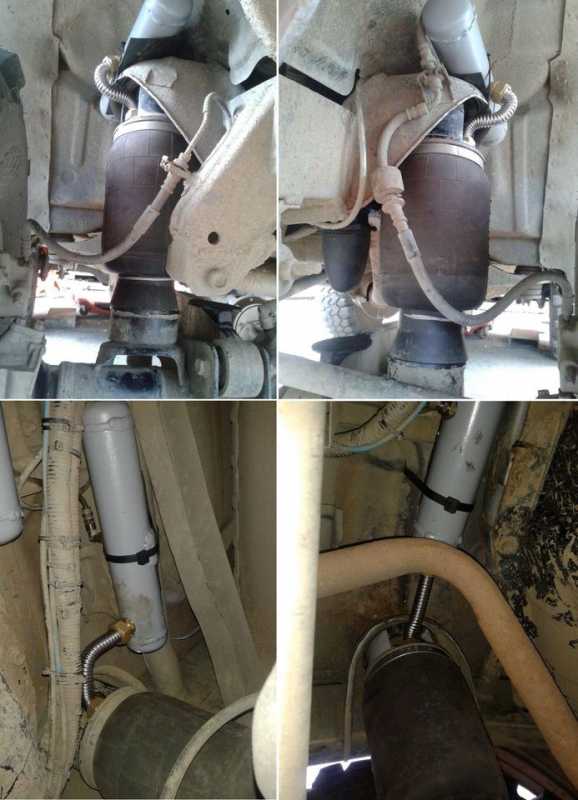

Coil springs have been replaced to air bags.

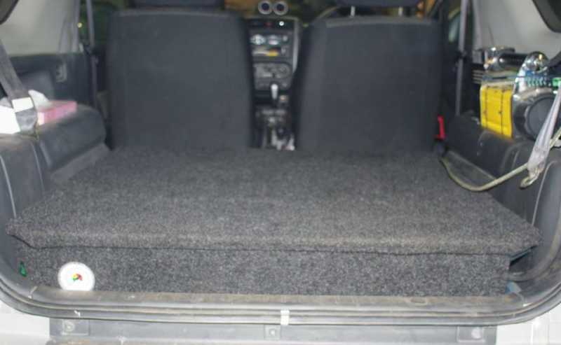

4 gals air tank is supplier of air for suspension, front ARB air locker and sometimes to fill tyres.

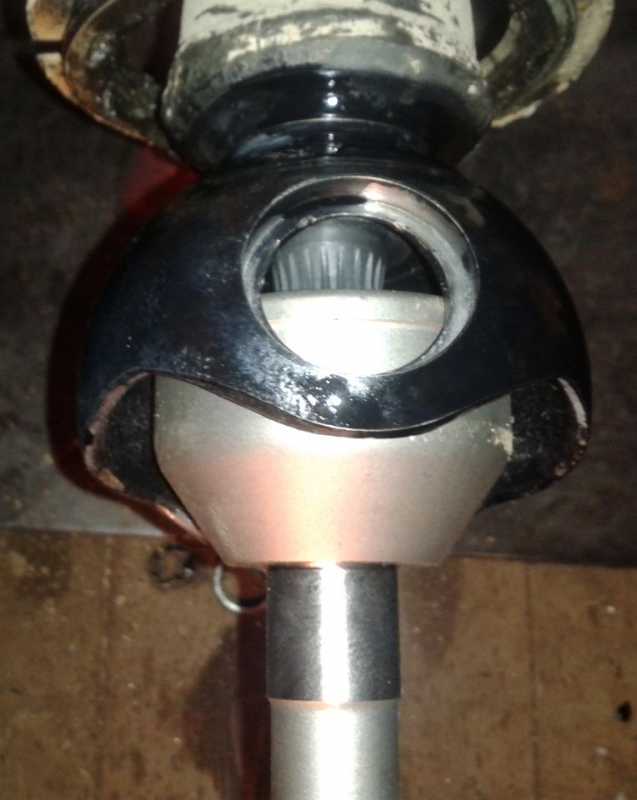

Stock t-case was replaced to Samurai t-case with 4.9 KIT.

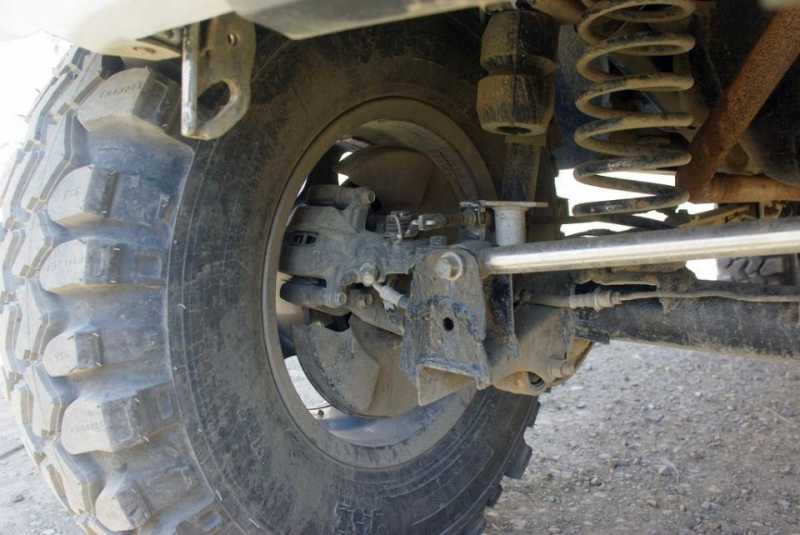

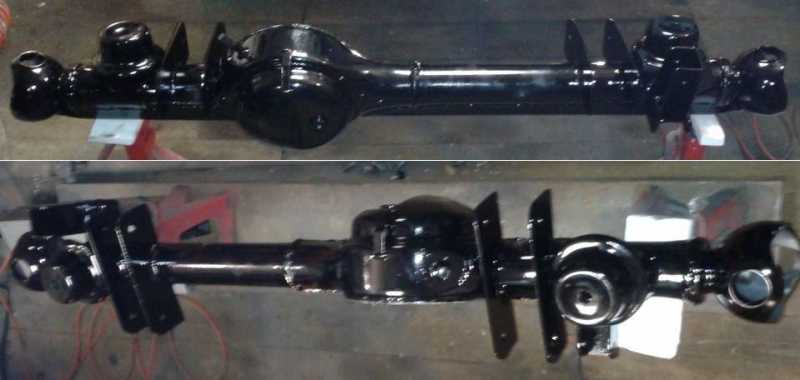

Front axle housing was rewelded. Radius arms over axle.
Stock front half-shafts were replaced to bigger shafts with Samurai cv-joints.

Rear axle is full floater with disc brakes.

Nice job mate well impressed with that where did you source the air bags from ?
- g r e e n
11 Oct 2013 11:47 #85802
by g r e e n
Replied by g r e e n on topic Suzuki Jimny on air suspension
Jimny is so small and light car so I don't have much choice. I found only two suitable sleeves. Firestone WO2-358-7012 and W26-358-9004. Other airbags are too large for our car.
I bought them on airbaggit.com.

Looks like a great job. Just not sure I see why.
Looks like you have lesser articulation than with normal shocks, these airbags don't look very tall. Probably why you have these Blocks on top and below them ?
If I should change suspension on the Jimny, I'd go for Fox Air Shocks.

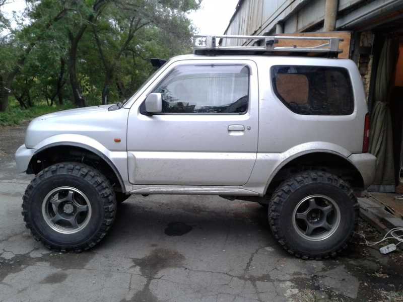

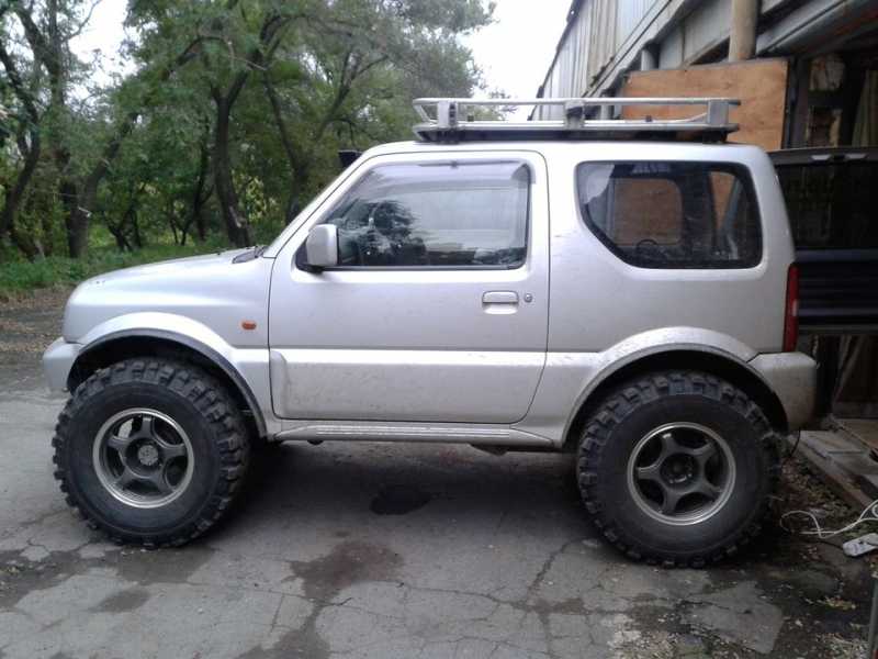

I can not brag about huge articulation and I don't worry about that. Total travel length of these air springs is about 15 cm. It's enough for me. I need comfortable suspension to drive on bumpy road. Also when I put a lot of things in my car it does not sag to bump stops because I inflate air bags more and go on same height as on empty car.
Air bags are empty. The car lays on bump stops
And this is ride height
