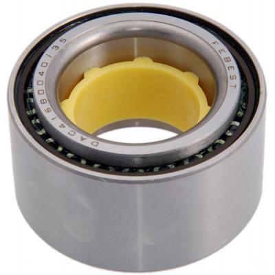

The inner race does slide in and out on them fairly easily, some versions are supplied with a nylon insert to retain the inner races during transport, note that this picture is NOT a Koyo brand and not sold by me,
Were the sealed ones obtained from me? If so I am not sure why they are sealed and why they appear different as I have always purchased from Koyo.
