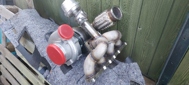

I've attached an example of project drift.....huge turbo from a twincharged M series.....decided I'd like to have LPG for a bit of economy.....DI LPG won't support enough power in standard form.....so just a supercharger.....unless I change my mind again
