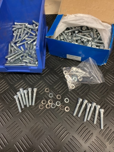

Replied by Lambert on topic Vacuum Hub bolts
Not directly related but the main bolts on avm ones are cap heads and as far as I am aware cap heads start at 10.6 so would be a suitable alternative. Certainly in the 90 thousand miles I have had them on Dreadnaught the only failure was internal and not related to either set of bolts.

Replied by Busta on topic Vacuum Hub bolts
A manual locking hub failure? Blasphemy!Lambert wrote: ... the only failure was internal and not related to either set of bolts.
It did have over 70000 miles on it at the time. Part of one of the bearing surfaces delaminated and was making an appalling noise.

06 Feb 2021 13:15 #232534
by Roger Fairclough
Replied by Roger Fairclough on topic Vacuum Hub bolts
Big end bolts are usually rated at or above 12 and no manufacturer would use them if there was any chance of failure due to shear.

06 Feb 2021 13:19 #232536
by Roger Fairclough
From memory, the flanges, whether solid or manually engaged are located by 2 hardened steel pins which should remove any chance of shear?
