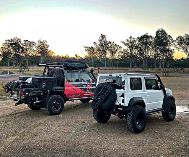

Replied by 300bhpton on topic 4th Gens on bigger than stock tyres
Hello guys,
I have a friend, owner of a 2020 Jimny.
we would like to install 33 tires on it. Actually, we already ordered Maxxis Creepy Crawlers 255/85R16, which are nearly 33x10-16.
We know that a guy in Australia have 33 tires and it works. Yes, we will have to trim a little, we have a +5cm suspension, so that should be ok for now.
the question is, what offset will we require for wheels to avoid any rub at suspension arms? I know that -
ET-25 will work, but I can’t find the information what is the minimum offset that works. -25 can be too wide as I understand.
thanks in advance.

- SANDU
21 Nov 2021 16:37 - 21 Nov 2021 16:38 #240271
by SANDU
Replied by SANDU on topic 4th Gens on bigger than stock tyres
as a better idea, this Jimny from Australia has a similar setup that we want to achieve:
I know we need to re-gear the transfer box, we will do it with Protrack gears and this should work enough.
We also know that the +5cm suspension will not be enough for the 33" diameter tires, and we will have to trim the fenders, but I think we will handle this after we fit the tires.
Still, we are unsure which offset to chose for these wheels.
I want them to sit inline with fender flares, but in the same time, I want to be sure they will not rub anywhere on suspension at full flex. This is why I posted here, in the hope to find a suggestion
Ring and pinion, we will not remove yet, because, if the future will be good, this car may sit on portals after that. It depends on the final budget.
I know from Australia that we need to upgrade the propshafts. The halfshafts and CVs are strong enough for 33" tires, they say.
And one more, the rear diff will soon be an ARB airlocker, so one weak point less.
