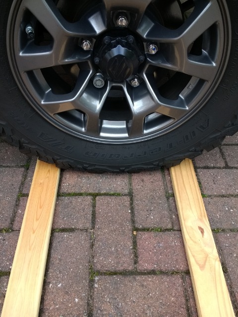

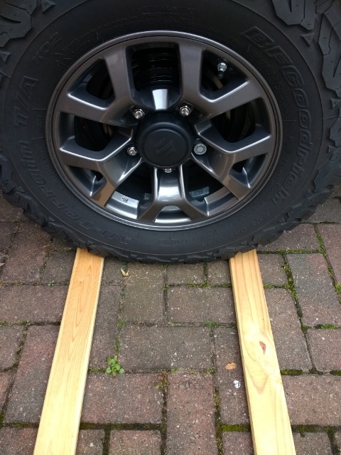

How about actually getting a tape measure and comparing the results :blush: :laugh:
Seriously though, different manufacturers state a given size, but the actual size can vary a fair bit. For comparison maybe some of the others here could post a measurement too? E.G. a 215/75r15 tyre is supposed to be 704mm tall according to tiresize.com/tyre-size-calculator/
I mention this because I had a horrible driveline issue with an old subaru which was caused by different brand tyres front to back. They measured nearly an inch taller on the back ones even though they were the same theoretic size...
