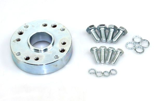

I’ve got a rock lobster transfer box as a side project, just in case the standard-ish (diffs changed) gearing doesn’t work out for me in the buggy project...
I’ve just ordered a JimnyBits conversion spacer -
So that - in theory - I can fit a standard Jimny rear propshaft...
And I’m in the process of buying a Jimny standard transfer box to put on the bench and attach standard mounting brackets so that I can have a reference / pattern...
So, my question... has anyone ever fitted an SJ / rocklobster transfer box in this way and used readily available standard Jimny propshafts, rather than having to rely on old / obsolete SJ parts...?

Based on recent experience, using a prop shaft company to adjust and then balance props was quite competitive to buying and refurbishing SJ props, and they are then the correct length rather than "close"X8GGY wrote: Sat in the shop contemplating...

SJ ones.
Although the mounts were "designed" for SJ props, they still needed quite a bit of adjustment for a proper fit.

The mounts on mine are probably not representative of the current designs. They were a very early prototype from ORA in probably 2007 so I expect there was more "tuning" work to be done in terms of positioning.
