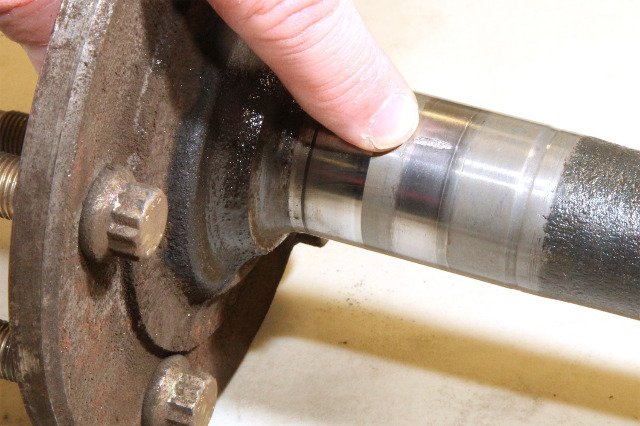

Replied by Jezz on topic Bearing retainer creep
Yes the shaft can wear. It is normally caused by bearing pick up and rotating the inner race.
Both the KAM rear shafts have suffered this on mine, (like it when i got it) due to lack of bearing changes. Hence my interest when you where talking about them reproducing some of there stuff.
I should add, Thats just a google pic, Not mine.
