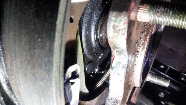

Hi Martin.
I've checked and it is the oil from the diff/axle.
Now the question is what has caused this? I did not offroading at all and run only about 6k miles since it's been replaced last Summer.
Thanks for your advice.
Regards, Gabor

Replied by mlines on topic Re:Oil leak at the rear off side wheel
Rear wheel bearing design on the jimny is awful, bearing is exposed to the elements so they can wear quickly. It is also possible to bend the shaft or axle casing as well which will cause premature failure

Replied by sniper on topic Oil leak at the rear off side wheel
Two bearings on a shaft, all the load at one end, constant shocks from potholes and bumps. Dirty hot environment it doesn't take a lot of explaining.
Early failure can be caused by many factors also, a single grain of sand whilst fitting is enough. Miss seating by the tiniest of fractions puts both races out of line and places enormous point loads on the balls or rollers. All generate heat and once the bearing is cooking the hardness is affected and it fails.
Bearings should be handled with food hygiene standards of cleanliness and their housings too, very difficult to do on a car......
Another sad variable is quality, some bearings are cheaply produced with poor quality steel and even worse heat treatments, always buy the best quality that you can. Saving a few pounds on bearings is not the thing to do, the jimny is pretty new to me but I understand that the Koyo are the bearings to use.

Replied by HUN on topic Oil leak at the rear off side wheel
Thank you all for your comment and advice.
A year ago I got fitted Koyo beatings by a mechanic and this repair will not be exception. As you pointed out fitting properly is at least as important as good quality materials. Unfortynately I have no control over fitting issues as I don't feel confident doing tasks like replacing bearings and bleeding brakes. I'm on the right track to achieve this in my life but it's just a poor timing for this learning excersise...
I've ordered everything from Martin (hopefully everything will be with me shortly), the car is in my garage so there is really no reason not to do myself except my confidence level...
I will see after tonight.
