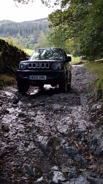

First proper green lane yesterday and I lost the clutch two or three times. Got very hot and had to let it cool before I could continue.
After the downhill section, it was fine... but
Have I killed it or is it fatally wounded?
Car has 60K miles so probably original factory clutch.
Advice as always appreciated.
