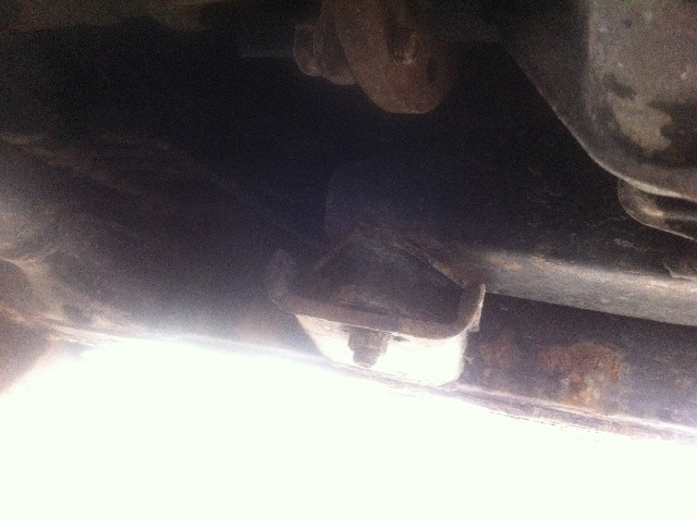

by kelky7777
Replied by kelky7777 on topic really loud vibration with slight judder
I checked and yes the woo woo has also decreased to barley perceptible. Basically it seems any weakness in the drive gear, mounts, or anything else contribute to noise.

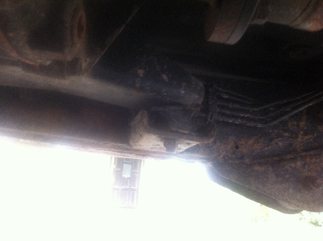

- kelky7777
30 Jun 2017 18:48 - 30 Jun 2017 18:49 #182404
by kelky7777
I had the hubs off the other day and they look fine, no wear or water. I had a good look at all the vacuum pipes and nothing obvious there. Checked the appropriate fuse under the dash. Maybe an electrical problem? This is regarding my other problem, 4x4 not working as the hubs aren't engaging.

Does the square metal backing contact the metal on the transfer mounts....makes a strange noise on accel?
