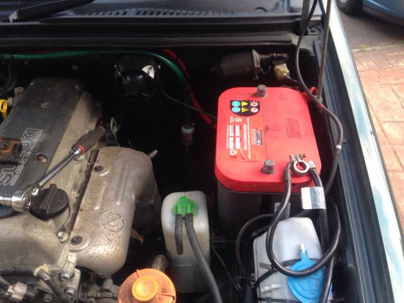

- Chazg83
03 Feb 2015 23:31 #136853
by Chazg83
Replied by Chazg83 on topic alternator upgrade winch and battery
- Chazg83
03 Feb 2015 23:33 #136854
by Chazg83
Think it's 95 amp can check if need be
- Riceye46
03 Feb 2015 23:34 #136855
by Riceye46
Replied by Riceye46 on topic alternator upgrade winch and battery
It's a champion c8000ewx
