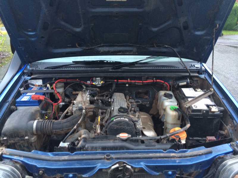

- Yellostreak
03 Feb 2015 20:47 - 03 Feb 2015 20:49 #136825
by Yellostreak
I have a 250A splitcharge system
Jimnybits tray and I robbed a near new battery from the wifes freelander2 which is brilliant and just fits!
All my non-essentials are now running of the 2nd battery and only the engine/lights etc run from the original battery which I upgraded to the best sensible money can buy (Bosch S4)
I have a nifty little switch which overrides the split charge and manually connects the two batteries together so I can use this if I need some extra umph to start the engine...
Problem I have now is with two winches, two batteries and a whole heap of heavy duty cables and electrical bits its starting to look like a power station under my bonnet!
