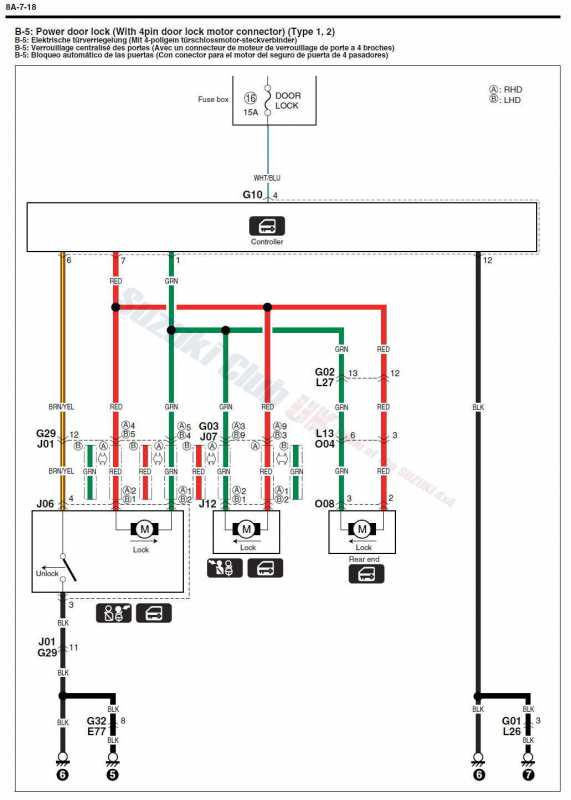

410shotgun wrote: fit a 2 wire locking motor run a twin flex from the door into the cab
and wire up as in diagram D

Did anyone figure this out? I have been trying to fit a simular system but cant figure out the jimny wiring. Trying to install this at the power locking controller that is type (1 2) 4 pin (5 wire) can get it to unlock on remote by attaching the devices lock negative signal to the cars unlock wire (dont understand how this works) but am then left with the green and red lock wires and it doesnt matter what I attach it will not lock again.
Thanks
Edit: For reference this is what I have and need to put together:

11 years 10 months ago #133081 by Crash
Replied by Crash on topic Problems installing keyless entry...
Still confused about this, emailed the people I bought it from and they wernt much help, basically said speak to a local specialist :/
