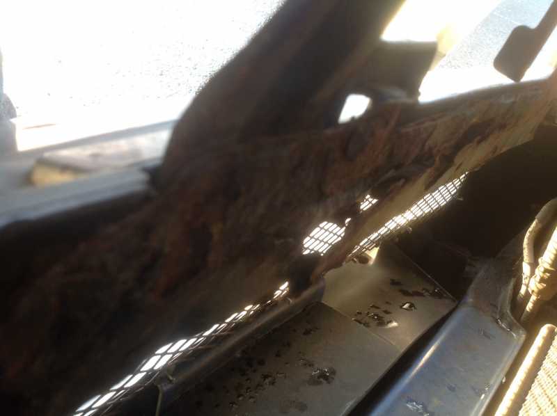

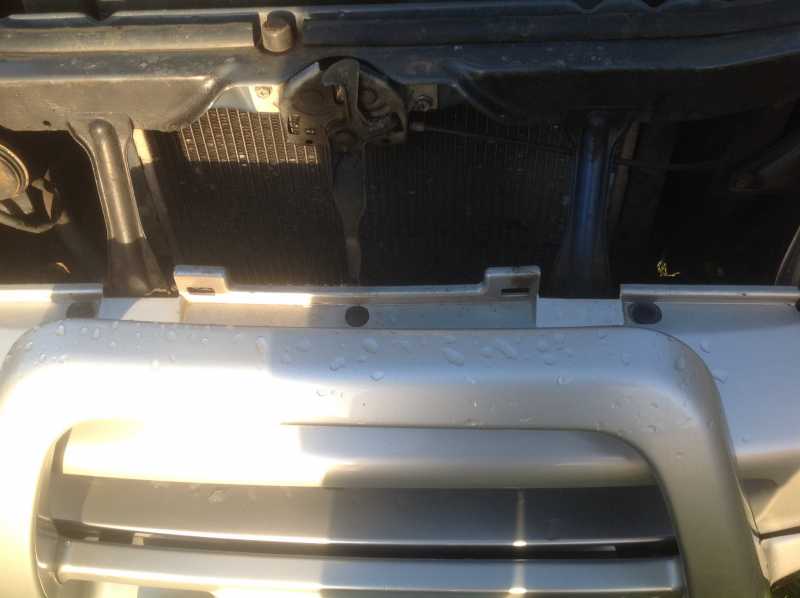

07 Mar 2014 17:47 #107572 by jimnylee
Replied by jimnylee on topic front metal structure rotten?
Hi here are some pictures of the effected area

07 Mar 2014 18:13 #107577 by meathumper
Replied by meathumper on topic front metal structure rotten?
Doesent look too bad at the minute, soon will bo though. I would cut it out and replace with suitable size box.

07 Mar 2014 18:17 #107578 by meathumper
Also take all the plastics off and check the inner sills/ body mounts. Rear cross member behind bumper/body mounts, boot floor, behind the head lights. Ive just welded all the above on mine.

07 Mar 2014 18:48 #107588 by helijohn
Replied by helijohn on topic front metal structure rotten?
meathumper wrote: Doesent look too bad at the minute, .
Yup, it looks well shot to me; it's the slam panel isn't it?
