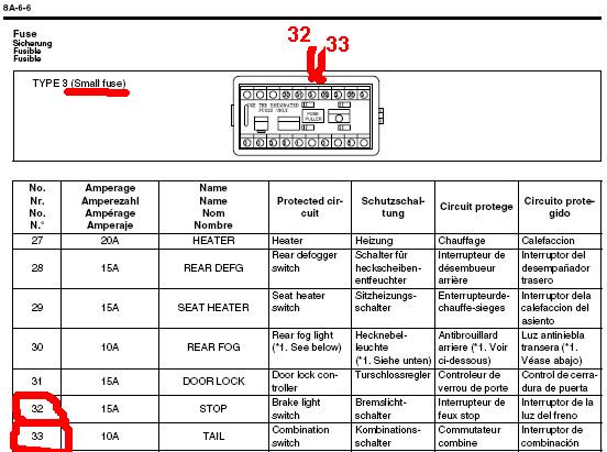

Replied by Halford on topic Hi Level braking light - 07 hardtop

Hi Halford,
Thanks for the diagrams. I have the 'small' fusebox on my 07.
The more I think about this, the more I think that there's a bad earth on the wiring. Going to see if I can bypass the bulbs' socket and connect the wiring directly to the bulb and check that the bulb socket isn't faulty. If that's not the problem, then I'll tear out some paneling this weekend and have a look for an earth or a short somewhere.
