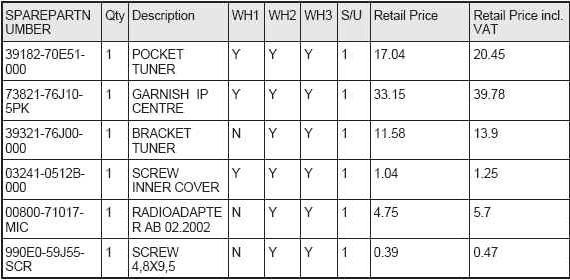

thanks for that pic in the brochure Andy, hadn't seen that before
Radio console set Part No. 990E0-59J55-000
I enquired with my local dealer and was advised that the part number has gone to a multi-supercession as below (if you add the individual prices they match Martins total price £81.55
I'm guessing that the "pocket tuner" at £17.04 is the tuner surround trim
and the "garnish IP centre" at £33.15 is the undersized single DIN tray

Martin,
Any chance you can get drawings of the parts to make sure what I thinking of is correct.
Cheers for the other replys, I did look at other posts but not seen this kit mentioned so not 100% sure what you get for £81
06 Nov 2013 10:46 #89588
Replied by mlines on topic Single din facia, where can I get this part??
I cannot get the pictures, however Halford is correct with the picture and parts list.
