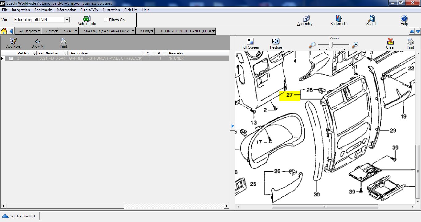

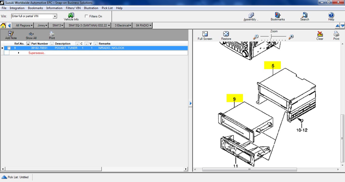

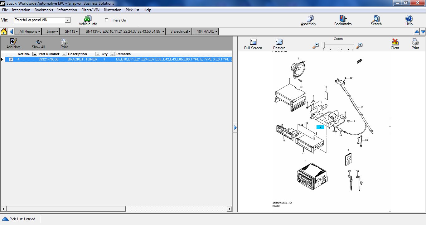

07 Nov 2013 20:05 #89851
by Halford
Replied by Halford on topic Single din facia, where can I get this part??
that's great Rhinoman
so the "garnish IP centre" (73821-76J10-5PK) at £39.78 is not the undersized single DIN tray, it's the square edged replacement fascia (as per post "double din radio trim for later Jimnys?? - by gilburton")
whilst the "pocket tuner" (39182-70E51-000) at £20.45 looks like it's the undersized single DIN tray
and I'm guessing that item 5 is the "bracket tuner" (39321-76J00-000) at £13.90
still looks like silly money though, my single DIN unit with USB/SD-Card didn't cost anywhere near that :S
