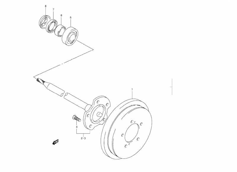

Has anyone got a link to a diagram to the Rear Wheel Half Shaft, Bearing, Seal and Retainer ...

One question:
Item-7 and Item-8 ... are they both in the axle housing

Replied by mlines on topic Re:Rear Half Shaft, Bearing, Seal and Retainer ...
7 is the oil seal and 8 is the oil splash shield.
Both normally are inside the end of axle when you pull the shaft out.
Sometimes the splash shield is missing if the previous owner or garage have lost it.

Thanks Martin - my splash seal was missing :sick: ... maybe that is why i had one on the shelf? :sick:
Today it falied MOT on 'poor rear brakes' ... N/S Drum was a bit wet with axle oil ... Hopefully this will fix it.
Tomorrow's job is to look at the O/Side.
