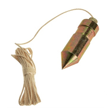

Use a plumb bob
Tie the plumb bob to the chassis near where the panard bolts so it hangs on the inside of the chassis and messure from the center of the panard rod bolt to the string and see what it messures in mm and this will tell you if that mount is out of alinement and ill messure it on mine and see what the difference is
Also messure from the center of the panard rod bolt on the axle to the trailing arm bracket on tue other side and ill do the same and see if that is bent at all

I'm confused at the plumb bob diagnosis. Is that just a piece of metal with a string attached? Or an actual piece of equipment you can buy.
07 Sep 2013 14:05 #82440
Replied by helijohn on topic Panhard rod
Both, you could use a washer on a bit of string but Poundland do the actual plumb lines so it's cheap as chips anyway.Reckerr wrote: Is that just a piece of metal with a string attached? Or an actual piece of equipment you can buy.

Use a nut with a bit of weight also thats why i put a pic of one up so you could see what it was
