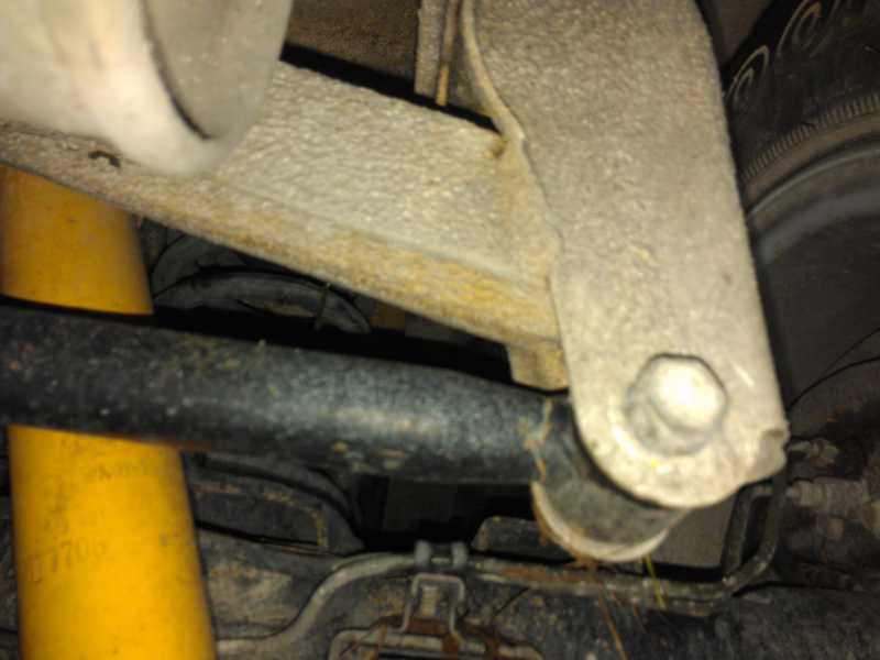

First pic. It's night so I'm sorry about the quality and lighting and such.

  • markyp2000
03 Sep 2013 00:07 #81973 by markyp2000
Replied by markyp2000 on topic Panhard rod
Panard rod yes it is but its quite slim line from off road armoury
  • Jimny_Aus
03 Sep 2013 00:09 #81974 by Jimny_Aus
Replied by Jimny_Aus on topic Panhard rod
Ahh yea mine is alot thicker from tough dog suspension, probably overkill though haha, wish we had an offroad armory here in AUS

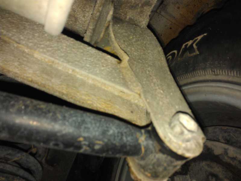

  • Reckerr
03 Sep 2013 00:10 #81975 by Reckerr
Replied by Reckerr on topic Panhard rod
ANother
Looks spot on to me. I replaced it with a standard rod. Cus I haven't the money for the kit or an adjustable as yet.

  • markyp2000
03 Sep 2013 00:12 #81977 by markyp2000
Looks ok cant see any metal stress and its brased
To ways of sorting it buy an adjustable panard rod or cut it and weld in half inch or so and then brace it just to add strenth
