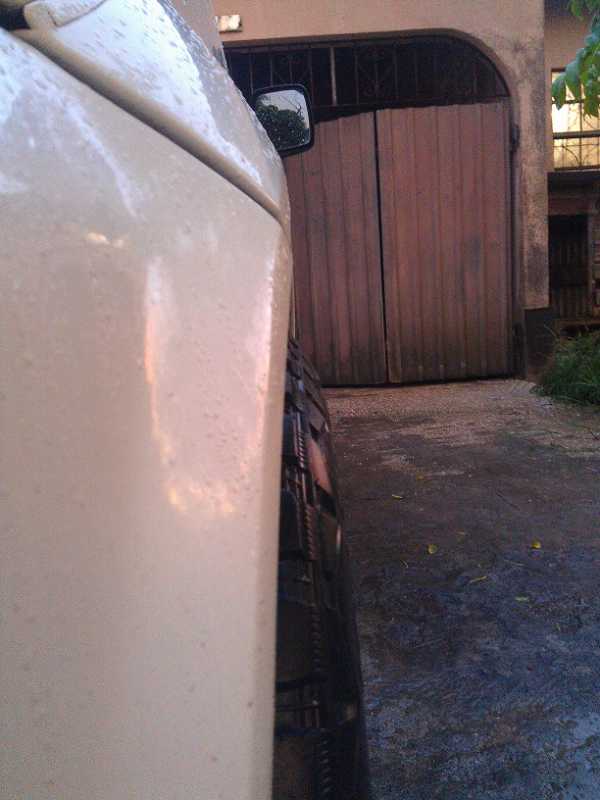

After countless time resizing and copy pasting my message so I don't have to type it over again. pasting it one more time from here is my original message.
Couldnt get my hand to touch the chassis and then to the rim. No lift and the tyres are a bit big. 215/75/15
Was at work today.
The left one(close to inside). The closest part of the chassis (a little curved lip sticking out right next to the shock)is 1.5" to the nearest part of the tyre. straight line.
The right one(farthest). Same end points is 2.5" to the nearest part.
Was at work today.

Messure from the chassis next to the bump stop to the wheel rim not the tyre mine if aroumd 4"
Yours is half an inch (13mm) the only things that could be bent is where it bolts the the chassis or the axle

alright got it done...grazed my elbow though...
The right side is 4"
the left side is 3.1/3.2
What's that mean..rim isn't bent. I swapped it.
It has a slight wobble though since the hit. Would that be from the half shaft bent? Or is there yet another component that could control that?
