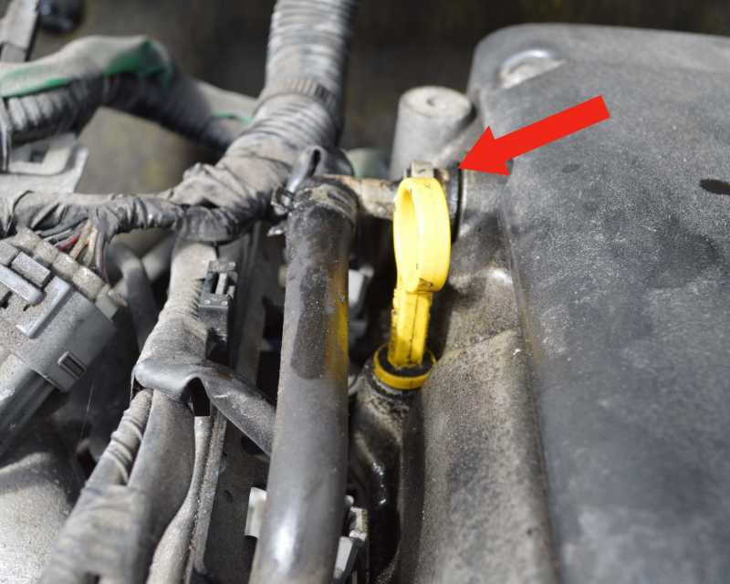

20 Jul 2013 14:55 #77657
by Chadd
Replied by Chadd on topic Jimny cuts out occasionally
20 Jul 2013 18:04 #77692
by facade
Replied by facade on topic Jimny cuts out occasionally
That valve cam cause a lumpy idle, but won't make it cut out and not restart.
There are 2 sensors on a twincam, camshaft and crank.
The cam sensor is dead easy to change, it is high up on the front of the engine, so it can sense a cam wheel. It is so easy to swap out because it very very rarely fails.
The crank sensor looks the same, but isn't an identical part, and is the one that fails because it is much more fiddly to change (an example of Sod's Law in action). They stop working when they get hot.
If you want to take a punt, buy a crank sensor and swap it out. If money is tight and you want a confirmatory diagnosis, wait till it plays up , then cool it down, (if you don't have a suitable aerosol, a fairy liquid bottle of cold water will do)
The crank sensor rarely gives a fault code, probably the ecu thinks that the engine has just stalled and doesn't log anything.
