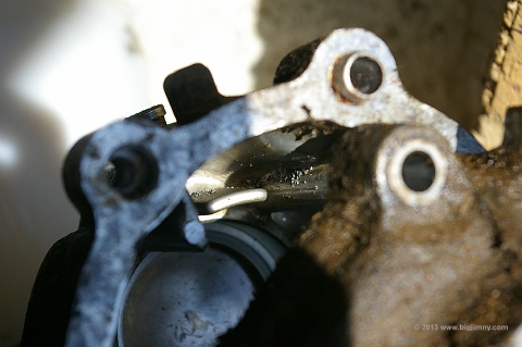

Inevitably swarf is generated and I am clear about this in the instructions.
Fortunately the drill takes the bulk outside the box.
I recommend you combine the activity with an oil change.
I also include a picture in the instructions that shows the swarf generated in an SJ box.
The SJ box has a protective internal lip underneath the breather that catches the swarf, here it is to the left of the picture. However this lip is generally covered in bits and dirt (to the right) which must have got there in general operation of the transfer box. It is pretty fine aluminum swarf so I think the effect is minimal.
