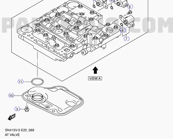

I didn't do the change myself. I let the dealer do it. The item at the bottom of the picture is the "filter". Part number is 26570-76J10. Suzuki refers to it as a strainer. It's accessible if you drain and drop the pan. Draining the pan removes (if memory serves) a little over half of the fluid.
Like you, I would lean toward more frequent changes than your dealer is recommending.

Ooh look a parts diagram that shows a device that cleans the oil in a automatic gearbox. And people are surprised when I let my anti main dealer bias show!
Cheers for your information both.
