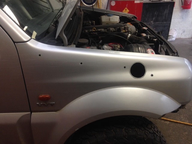

Got mines on with a homemade template. Not as bad as I thought it might be - didn't take long in the end

By the way, Riccys template on page one will not do for a TJM airtec snorkel, it is a different bolt pattern. Mine had 6 pcs 10-12mm holes for M8 bolts and 81mm big hole.
