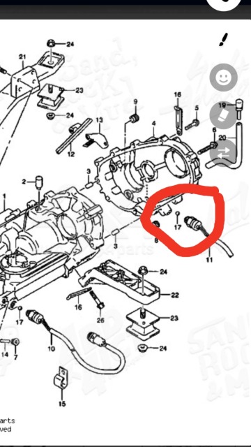

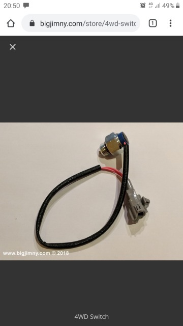

05 Jan 2020 18:36 #217027
by Cvejic
Replied by Cvejic on topic Suzuki Jimny 2007 problem 4WD

- Cvejic
06 Jan 2020 21:49 #217074
by Cvejic
Replied by Cvejic on topic Re:Suzuki Jimny 2007 problem 4WD
At me then it flashes twice a second, I did not measure accurately. To mention, no matter what it is flashing light 4wd works, the problem arises at shutdown 4wd. The 4wd switch made the joint, so i'm interested in what the role of the ball bearing is and if there can be a problem in it?

07 Jan 2020 05:01 #217075
Replied by Lambert on topic Re:Suzuki Jimny 2007 problem 4WD
The ball is effectively acting as a detent to provide correct location for the switch to work against.
