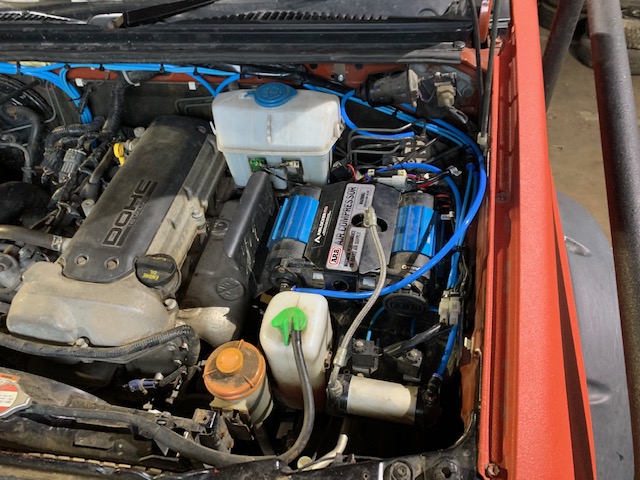

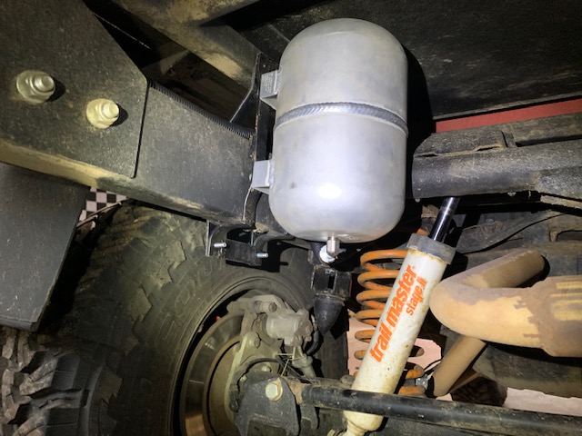

ARB compressors with the airline kit are ideal. Ive got the twin one with a small air tank under the back in Ulysses. Compressor under the bonnet isnt too noisy either. Fills the airtank via an air solenoid so I can isolate it full or empty as I want. Airline socket on the back. Its enough without the tank though...

Replied by Riccy on topic On Board Air
Nice one
I think the single cylinder one will work just as well, but maybe slightly slower for tyre inflation. The ARB ones are great and come with a good quality wiring harness and cabin switch.
To mount it where I have you will need to move the screenwash bottle, this gives you two threaded holes and you will find a third just beside the coolant reservoir bottle, these give you convenient points to mount a L shaped plate for the compressor. M6 bolts for the holes there and use some rubber washers between the plate and body to quieten it a bit. I just made some brackets to attach the screenwash bottle to the body as in pic above and found all the hoses and wires reach with no modification. Bonus side effect is the exhaust manifold heats the screenwash a bit on cold days.
You can easily buy push-fit airline adapters to use longer runs of the blue pipe, this is how I have fitted the tank and air socket further away from the compressor. I think I used 1/4" BSP fittings to 8mm pipe for it with some PTFE tape/compound to make up the slightly wrong thread (all ARB stuff is NPT thread for the Americans annoyingly and ARB air sockets use their own unique fitting, meaning you need their hose and accessories).
