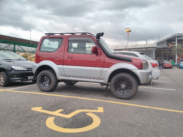

I finally went ahead with a lift for my Jimny after much deliberation (trailmaster 2"). It was done at my local garage and I'm just slightly concerned that the back looks higher than the front. Is that how it's meant to be, or is have they maybe got the springs on wrong?

It does look a little high at the back and yes front springs on the rear will do that.

Yup that looks much more level than mine. Great looking Jimny!

what Trail Master lift kit did you get? My 3" TM kit was also like that. Apparently because that kit was made to suit a heavy load. I fixed it with a couple of 15mm spring spacers in the front.
