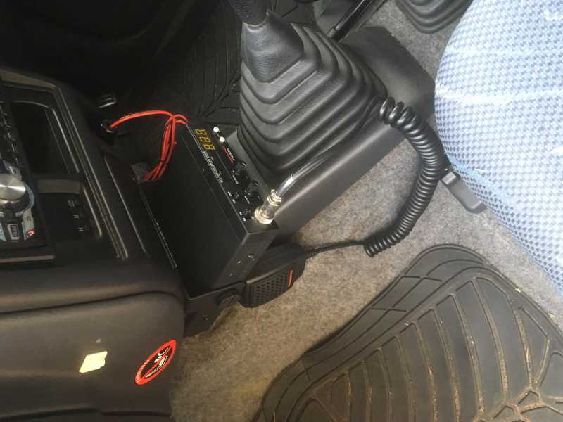

All fitted now.
I went to check the SWR, and either my setup was perfect or I did something wrong when checking it as the needle on meter didn't move. I followed the instructions that came with the meter, but I couldn't seem to make head nor tail of what I was meant to be doing. How do you check the SWR?
