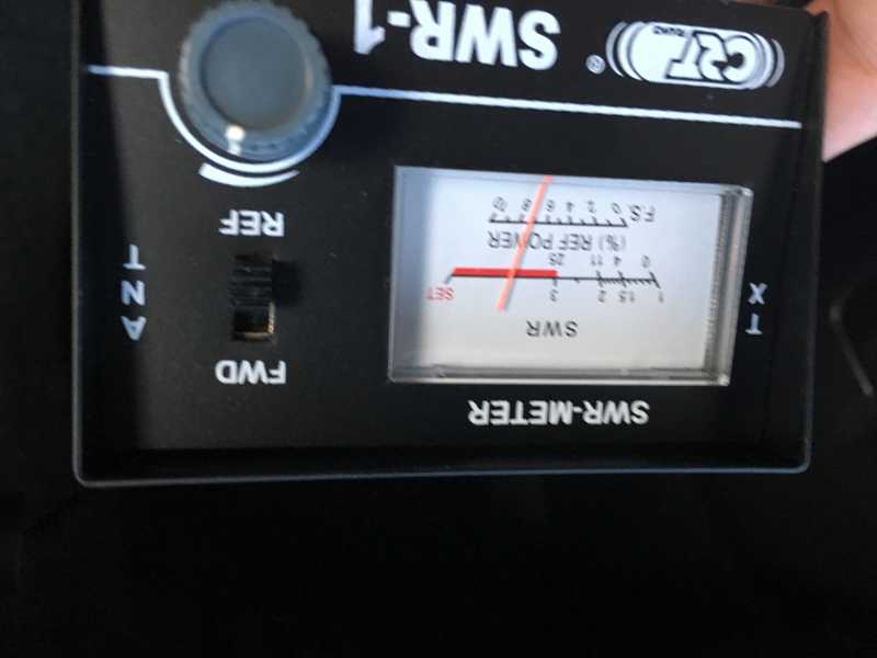

by mark98

Replied by 1066Boy on topic Tell me about CB's
Thats way too high!
1st, Set the meter as i said on channel 20.
2nd, leaving the setting as is, check reflected reading on channel 1 and 40.
You should get 2 different readings if the antenna is out of tune.
If you get the same reading on 1 & 40 after setting the meter on 20, start checking
the coax cable for damage.

I thought it wasn't right. I'll look at the cable tomorrow. Hopefully its not damaged, didn't look it when I ran it through the car. :dry:
Replied by mark98 on topic Tell me about CB's
1066Boy wrote: Thats way too high!

Right, I've had some minor success. By removing the rubber protector boot thong off the base of the mag mount, I've been able to get the SWR down to around 2.8-3, which is still far too high. I presume the aerial and coax cable are all functional as while doing a test, I got quite a surprise when I heard some voices coming through radio, talking in an indeterminate foreign language. So, I think I may potentially have a fairly serious ground plane issue, as there are no obvious problems with the coax cable. Any ideas how to lower the SWR further?
It may be a silly question but is the cb set to EU rather than UK? :blink:
