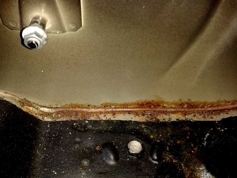

took off the rear wing panels and found the rust had spread further than I'd first thought

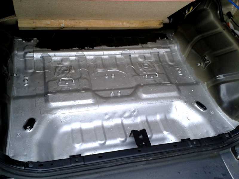

so rubbed down and treat again with rust convertor
and later smothered everything in silver hammerite, so any further rusting will be easy to spot
so what is this all about ?
it's top down rust, it hasn't penetrated from below
is it just condensation pooling on the rear floor ?
is it ingress through the seal along the edge of the floor ?
hopefully all sorted now, will check again in month to see if the tin worm has returned :dry:

Nice job Halford looks clean and tidy, you should add some more sound proofing I covered mine with as much as I could when I had the back seats out to add rear speakers it does make a difference

I've just replaced my boot floor and on mine I think that water had been getting in along the seal where the floor meets the arch and rear crossmember. These parts are only spot welded and then sealed with a sealer that seems to perish over time.
I've seam welded mine now, coated both sides in epoxy and then underseal on the outside. If it rusts again I think I'll just roll it over a cliff :whistle:
