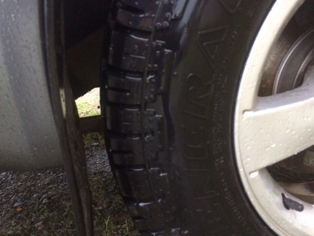

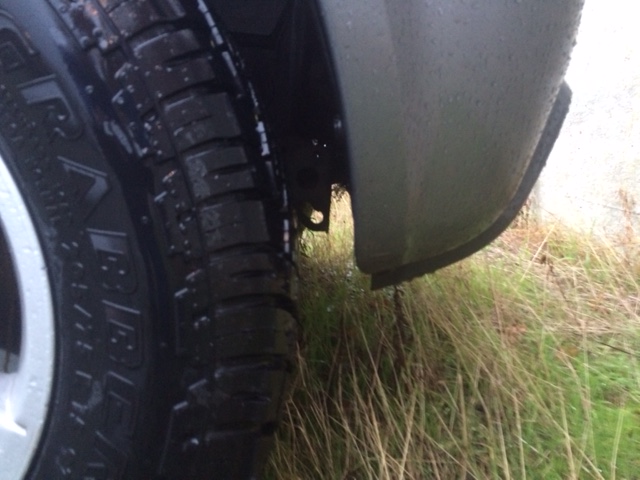

As you know I have fitted General Grabbers 205 75 15. My car is 2007 has factory mud flaps front and rear. I have measured the distance between the tyre and the mud flap and tyre and front bumper. The car is on standard springs etc.
Front Tyre to mud flap 20mm gap.
Front Tyre to bumper 40mm gap.
Overall diameter of the tyre on the wheel (side to side not top to bottom) is 690mm.
These measurements were taken with the wheels in line with the rears.
The tyres don't rub the mud flaps at any point from lock to lock.
Hope this helps you.
