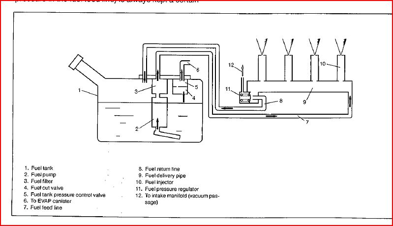

Has any one done a petrol tank breather or does it not need one??? Cheers

i thought systems that had fuel injection were pressurised. i would have thought if the jimny tank needed a breather it would have had one. or are you thinking of an extended breather like the axle and box breathers ?

I'm not 100% positive but I'm sure the tank isn't sealed. If it was it would create a mahoosive vacuum. It's only pressurised from the pump onwards. The fumes are drawn through the EVAP canister are dealt with by the engine. So there is no open to the atmosphere breather like NA jamjars.
Of course I could be wrong lol.

I am pretty sure fuel tanks have to have a breather.

Yeah I mean a longer one like the axle breathers? Just some one said about it the other day to me and I'm not sure?? Lolrobs5230 wrote: i thought systems that had fuel injection were pressurised. i would have thought if the jimny tank needed a breather it would have had one. or are you thinking of an extended breather like the axle and box breathers ?
