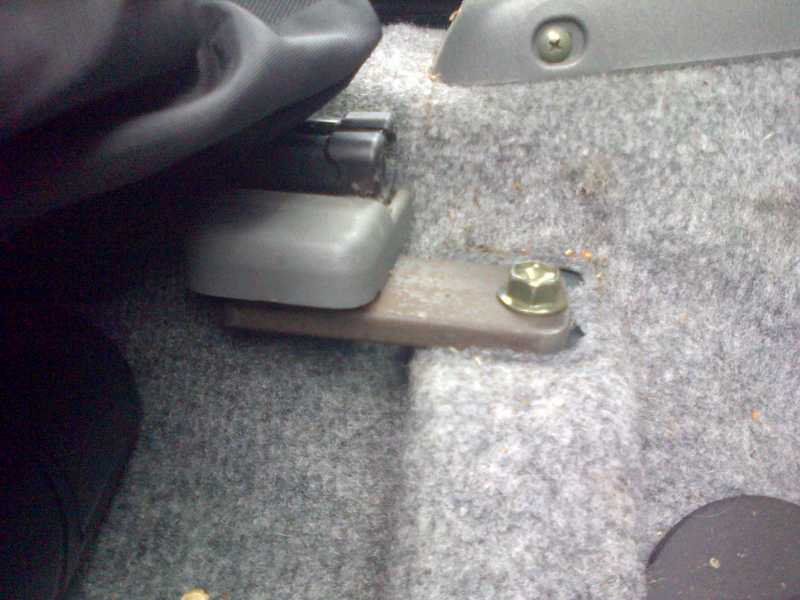

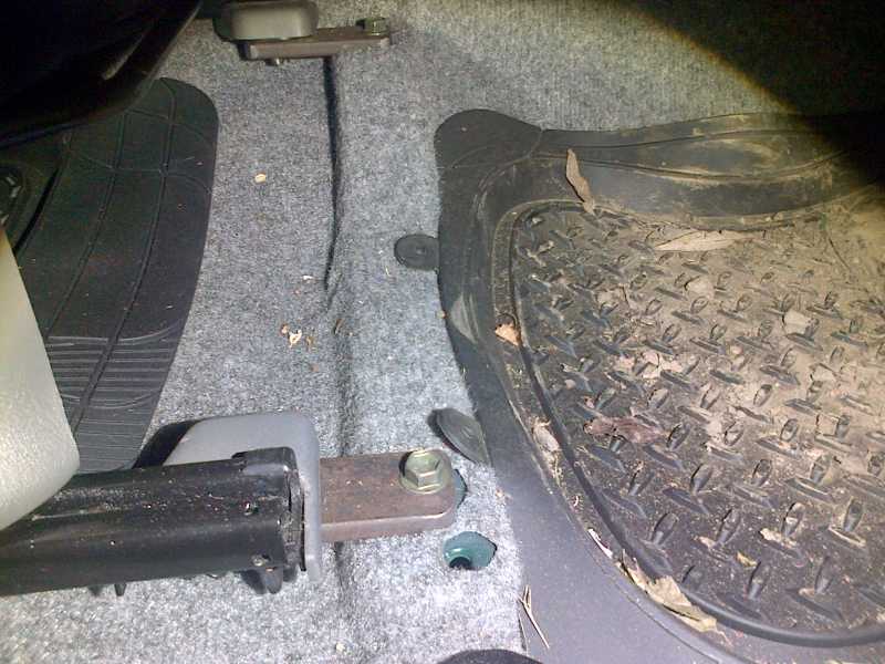

for any one that wants there seat moved back, hear is what i done

chriscallow wrote: for any one that wants there seat moved back, hear is what i done
Looks good.

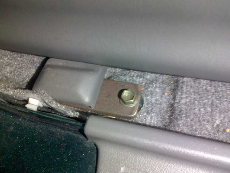

Do you have a pic of the one at the rear near the door please?
Looks good.
