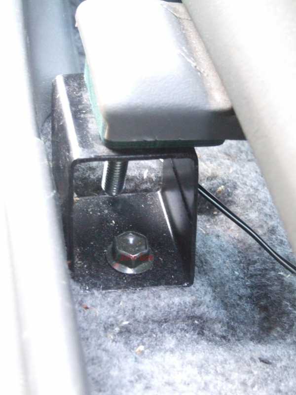

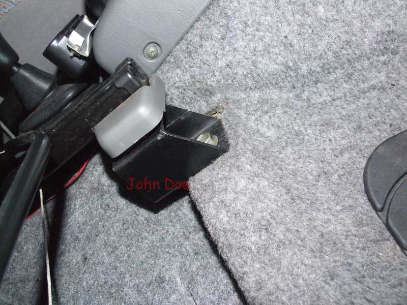

I fabricated some brackets from 50x50x5mm tube. Cut into a parallelogram shape it means you can access the bolts easily. You can move the position of the top bolt as far back as you wish as long as you can reach the pedals. Watch height as you need clearance for your knees under the steering wheel. I also added another inch height for the rear brackets. This way you can keep and use the existing bolts lower-to-floor but use longer bolts of your own for the upper-to-seat.

helijohn wrote: I fabricated some brackets from 50x50x5mm tube. Cut into a parallelogram shape it means you can access the bolts easily. You can move the position of the top bolt as far back as you wish as long as you can reach the pedals. Watch height as you need clearance for your knees under the steering wheel. I also added another inch height for the rear brackets. This way you can keep and use the existing bolts lower-to-floor but use longer bolts of your own for the upper-to-seat.
How did you get on with the inside (tunnel) fitting John, use the same :unsure:
Having looked again at the pics I can see one is of the inner fitting .... :pinch:
