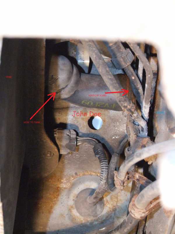

So what I need to do is get some wire, (coat hanger stuff). I can use a long piece of wire to reach from the wheel side of the chassis. Weld wire was suggested earlier. The WD40 pipe won't reach. Flood the rim of the rubber pipe, insert the wire to create an opening for the WD40 to get in and then rinse and repeat??? Is that sort of what you mean with a bit of adaptation?
Here's a pic that shows the restricted access.
I'd like to use this instead if I can save the fitting at the fuel flap end.
www.viperperformance.co.uk/productsearch.php?xscId=10054

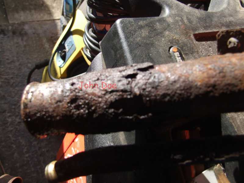

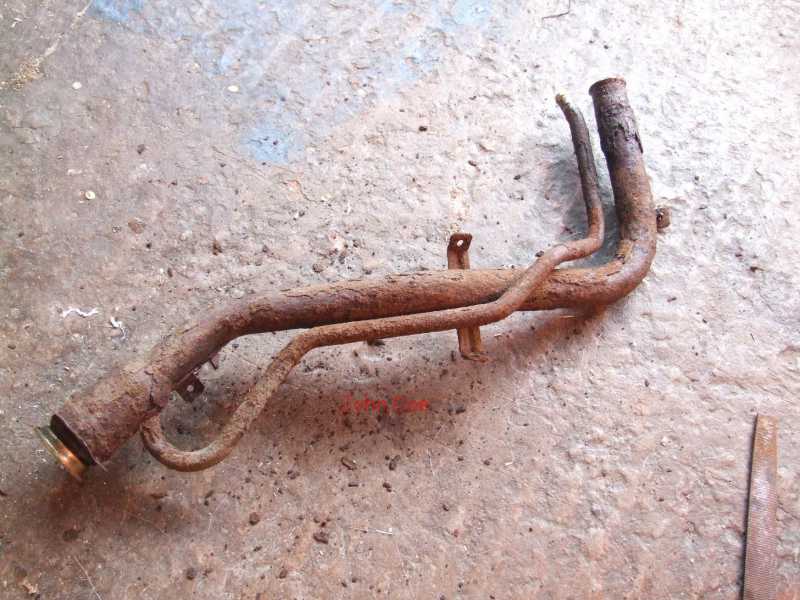

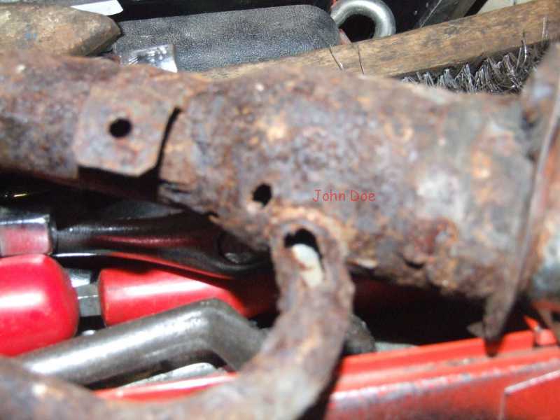

I have to say a big thank you cos WAHAY, it is off!! :ohmy: I did it your way. I used a really long screwdriver and lots of WD40.
Thanks to all for the guidance.
Looks like most of the metal has gone!
I'd say defo most has gone. I don't think I can re-use it.
So now the replacement is on the way. :( Just hope it goes on quicker than this came off - 8 hours!!
