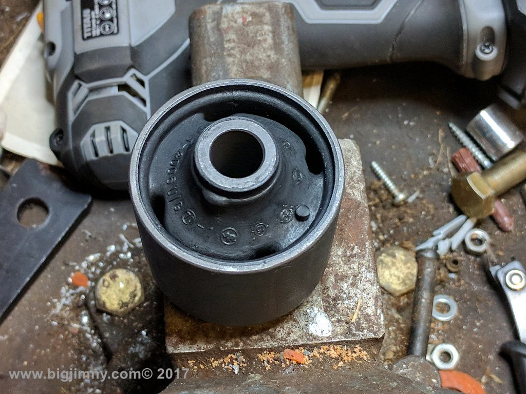

Corrected Rear Arms
jimny_IMG_20171017_191842
If you look around the internet, there is a lot of advice and conversation around castor correction for the front radius arms following a spring lift. However there is a lot less discussed about rear axle correction. Clearly "castor correction" does not apply to the rear but there is still an adverse effect due to a spring lift. There are two main effects, the nose of the differential is at the wrong angle which increases the angles the propshaft has to cope with and the spring mounts are not aligned top and bottom resulting in "banana" springs.

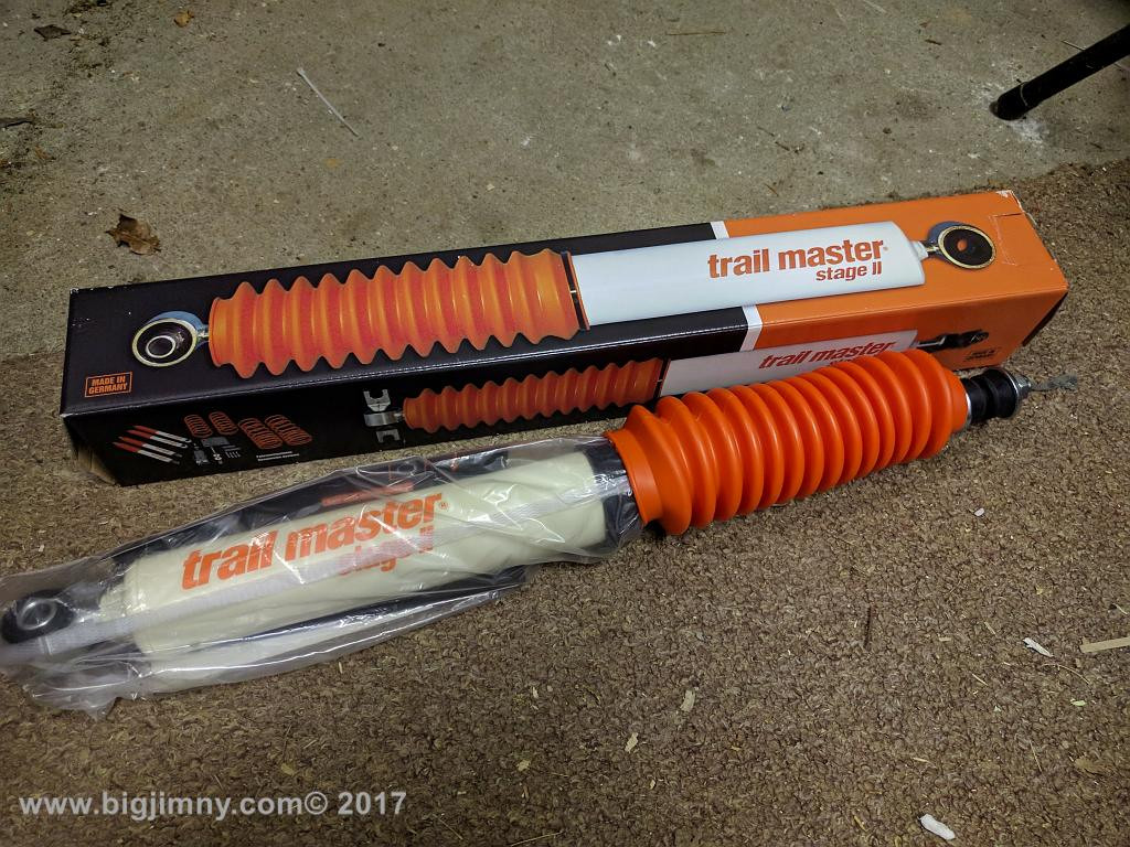

jimny_IMG_20171006_190403
I am sure I accidentally sold the shock absorbers I had put aside for my refresh of the suspension on BigJimny. Therefore I ordered a new set plus a set of bump stop extenders for the front. Now to get around to putting them on before I sell them again :)

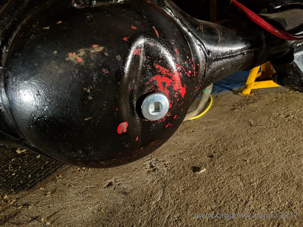

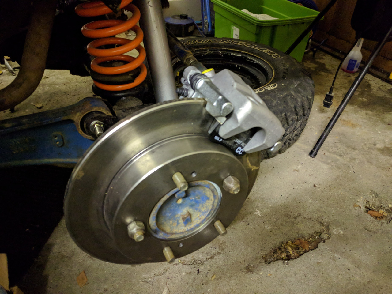

IMG_20170923_194017
Work has continued over the last couple of days with the re-assembly. First the differential was replaced. I ensured the filler and drain plugs were removed (because this would have been an ideal time to "unstick" them if they had corroded in position) and then cleaned up the housing face.
I then coated the face with sealant, lifted the differential into place and bolted it up.
