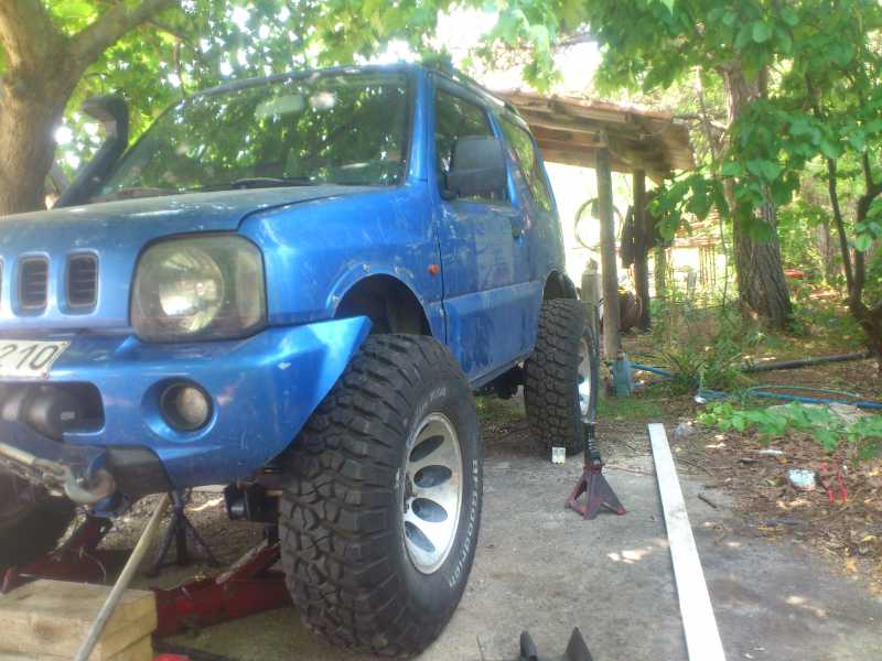

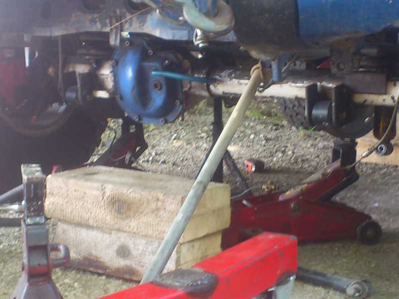

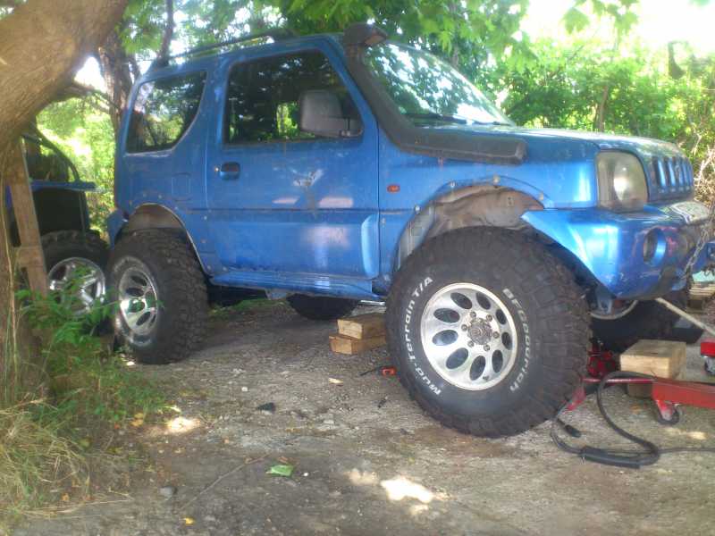

The front axle is in place. Some more testing and it's ready.
The driveshafts are in the workshop to make them sorter due too the patrol 3rd member is bigger and longer than the
stock jimny one.
Also willwood hydraulic handbreak is ready to go on.
After that testing to see if everything works fine and then my brothers car will follow.
stock jimny one.
