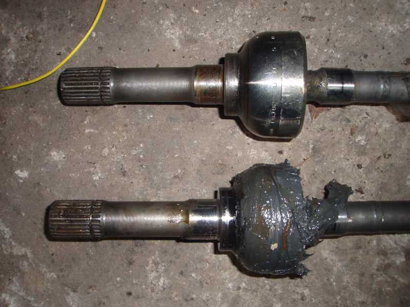

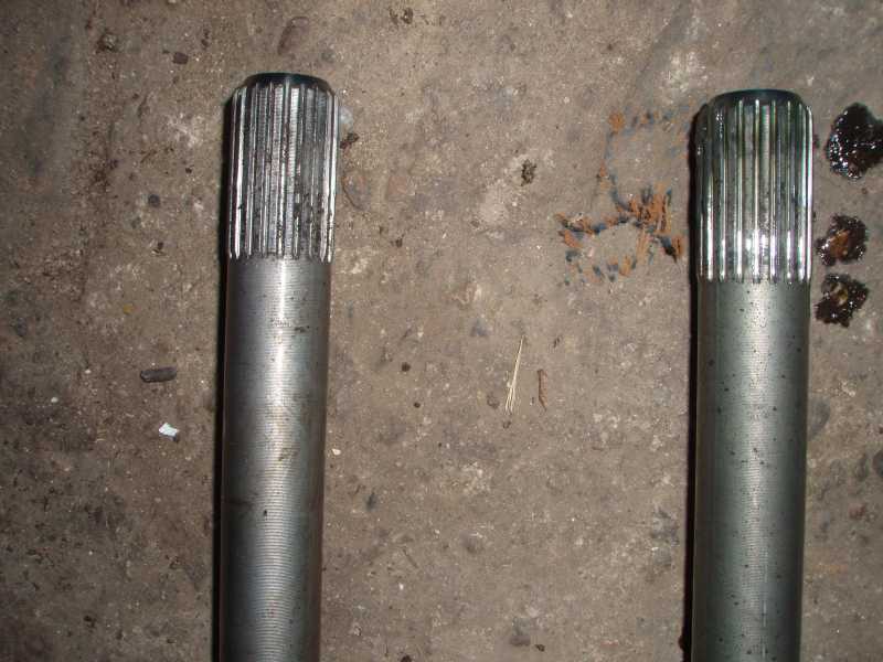

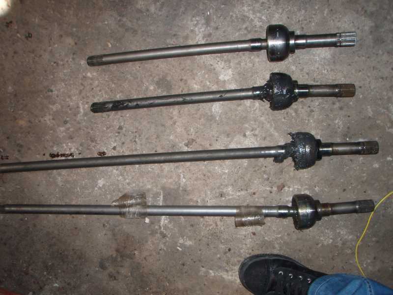

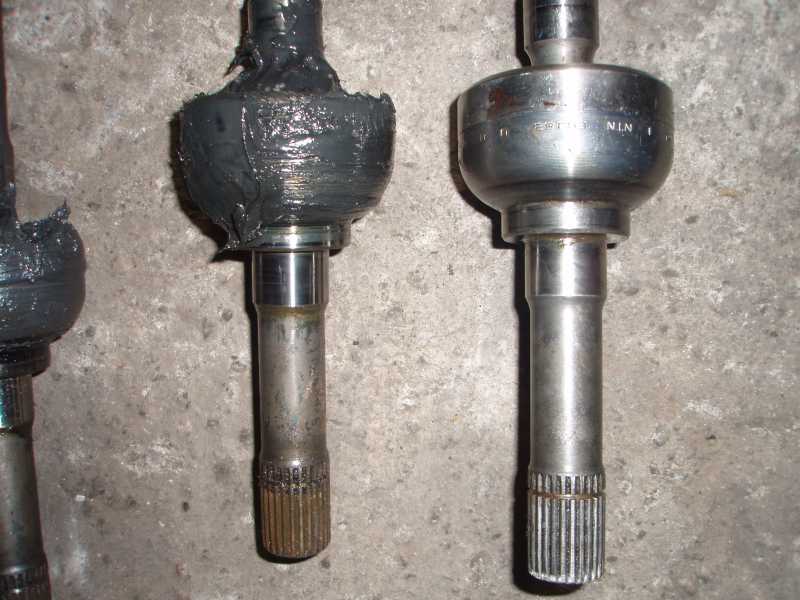

Today i found the pics from my front arb instalation with the HD axleshafts and cv joint.
On pics the clean are the hd and those with the grease are the stock one.
As you can see, they are a straight replacement and they can handle until 33'' tires with front arb locked.

Where did you get those from ?
  • Delvederis
06 Mar 2013 23:17 #64816 by Delvederis
Replied by Delvederis on topic Jimny from Greece
Hello, i took them from a friend of mine who put hilux axles in his car.
They are from subaru. In pics you can see the part number.
