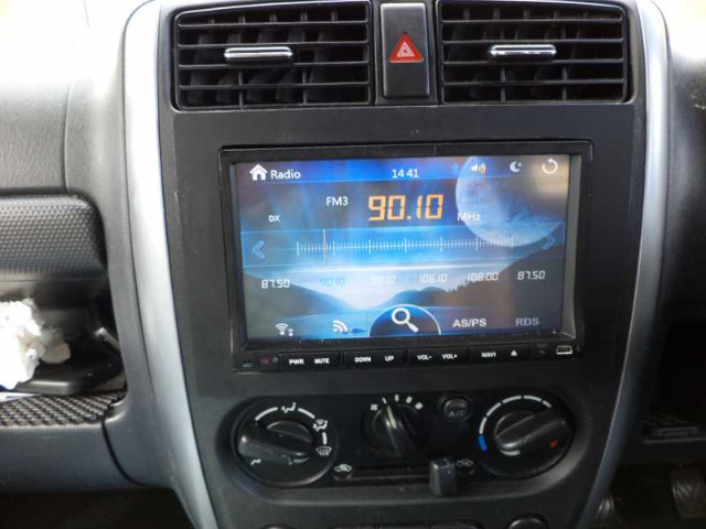

Mine was a flip front so bigger than standard double din and if I remember it was a very similar gap as yours with gaps both sides and a snug fit top and bottom.
I bought a universal flat trim and glued it on but I had to curve it slightly with a heat gun so that it would stick without springing off and I also eased the bottom edge to allow the stereo face to flip up as it caught slightly when it moved.

Cheers.
You can actually buy a replacement full fascia, the whole panel with a square cornered double din hole, but it's extortionate at about £100 from various sellers.

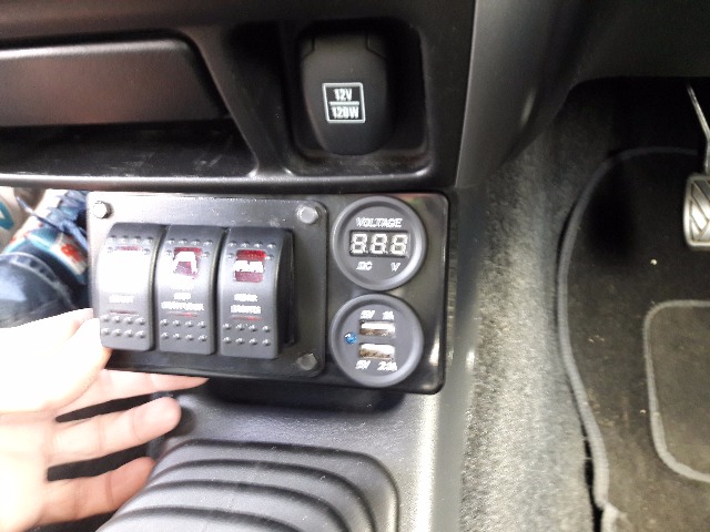

08 Apr 2017 18:26 - 08 Apr 2017 18:29 #180073
Replied by Riccy on topic Ant's 'stealth' gray Jimny, story so far

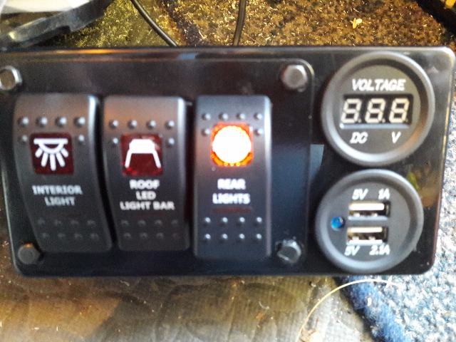

No eBay APP ID and/or Cert ID defined in Kunena configurationthey look good on the angle,
ive seen this (for a defender), but i think could be adapted for a jimny...
Ive a similar set of carling switches that need somewhere to go and was wondering about the roof, seems a nice bit of space just above the light that could be handy
Riccy
edit - this pic shows it upside down :evil:
Riccy
