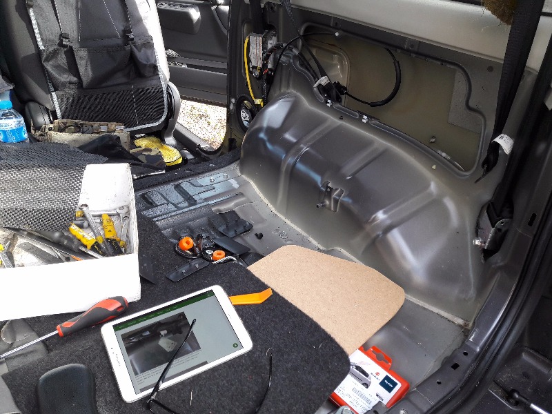

Fitted bigger front speakers 5" per the few photo guides I found on here... Giant pain the the ass getting the speaker grilles cut out the Footwell trims to not only accommodate the bigger speakers but to get the back end of the bigger speakers to align just right with the hole behind so the trim doesn't stick out. Got there in the end after two attempts.
Also fitted same speakers in the back and other than the palava of having to take all the trims out, these were a lot easier. Mind you since I had the trims.off I took the opportunity to unbolt the rear top seat belt mounts and stowed them behind the trim in padded wrapping to avoid rattles.

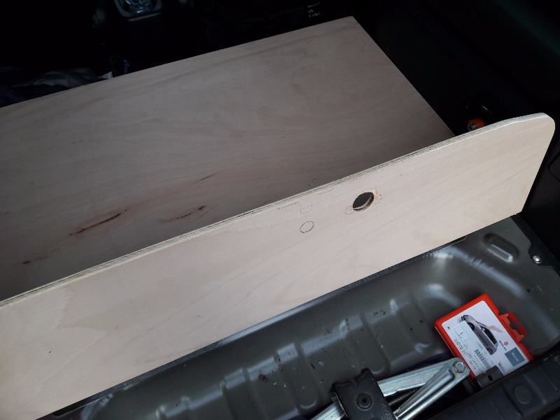

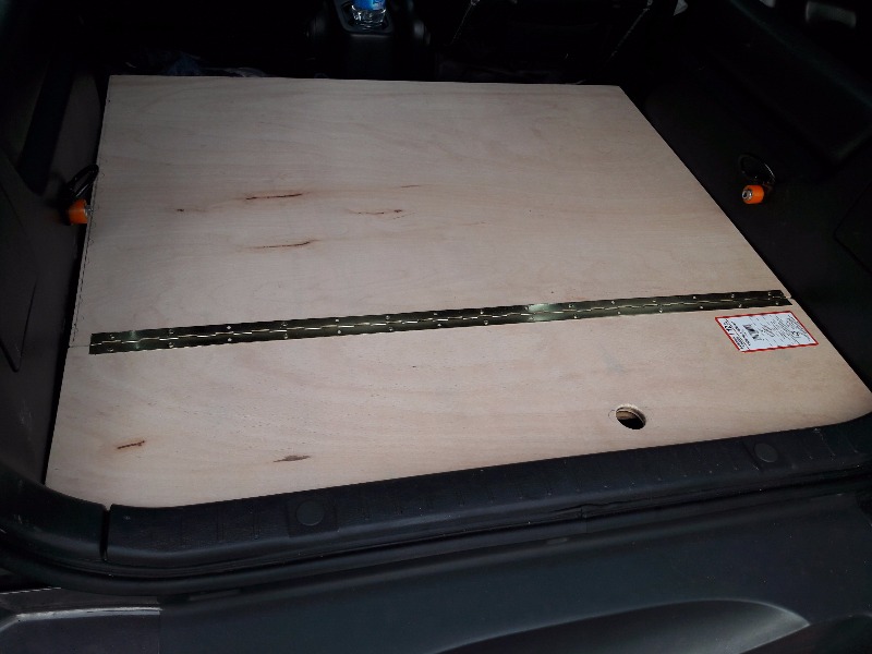

Then cut my plywood floor from the cardboard template I'd made, including a piano hinged section to access the jack and tools compartment. I have car carpet ready to cut and fit next weekend.

I like the hinged boot floor, nice one.
