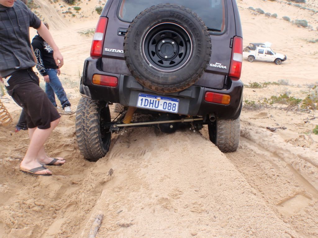

Gotta be time for a update aye? :ohmy:

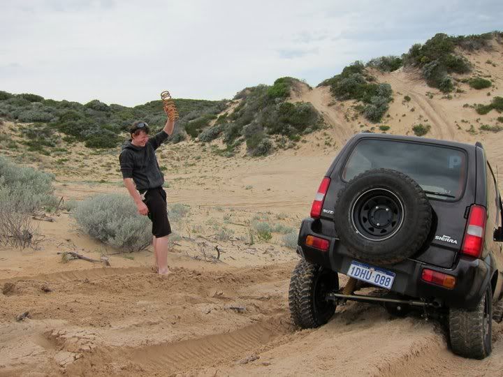

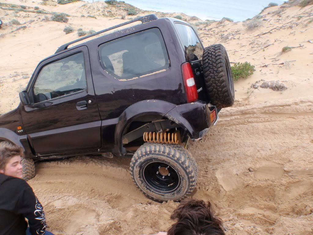

Here's some pics from a beach trip i did last week...were i bent my front diff
[/img]
[/img]
[/img]
[/img]
[/img]
[/img]

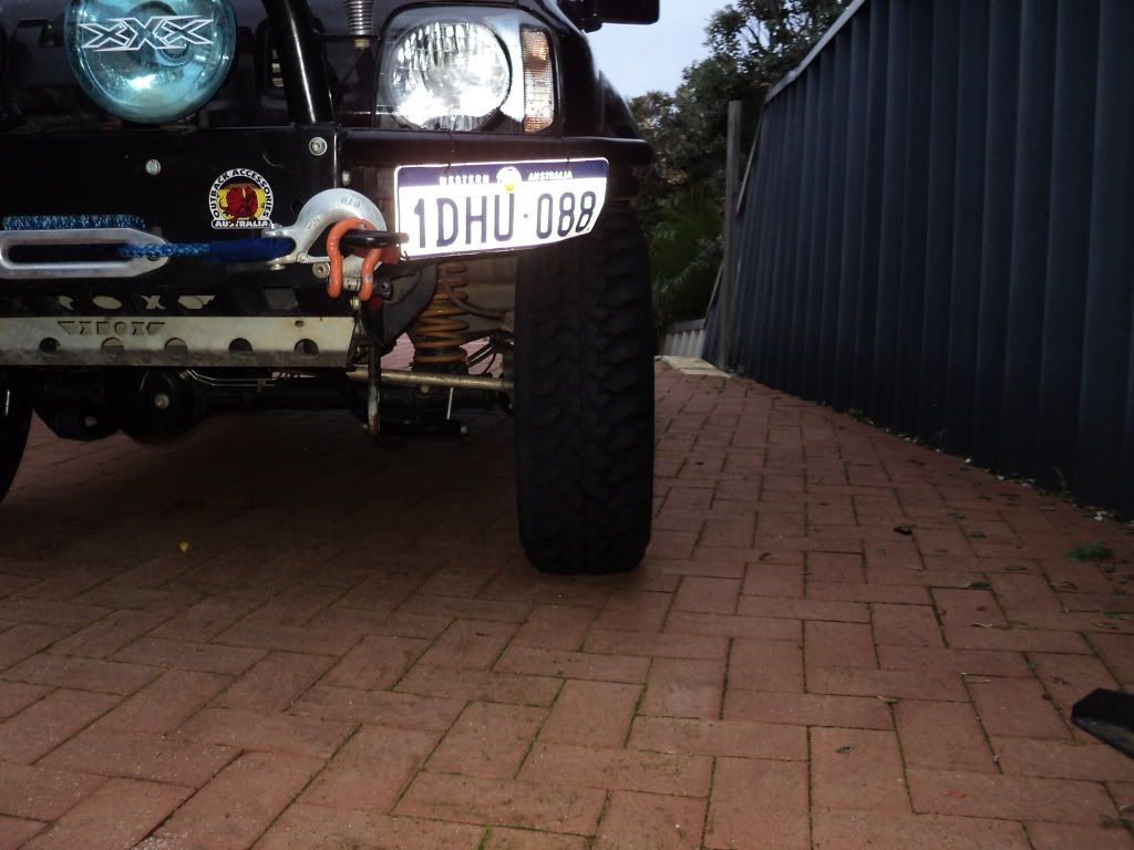

Bent front diff

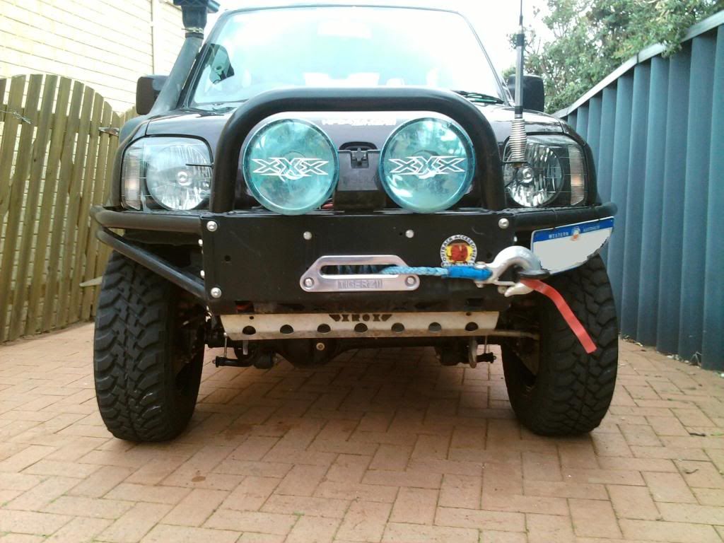

The plan is now to build the ultimate front diff:
-New housing brace with ORA axle trusses, knuckle gussets, diff guard, front air locker and maybe some HD axle's if can find some.
New fairlead fitted for the 9000LB winch with rope
Also got some longer brake lines on there way, new winch rated springs to correct front end sag and new CUSTOM shocks(front only), which will be around 3"s longer and should provide some good front end flex
. I will also have to make up some coil retainers to stop those darn copils from falling out. :woohoo:
Cheers.
Andy
