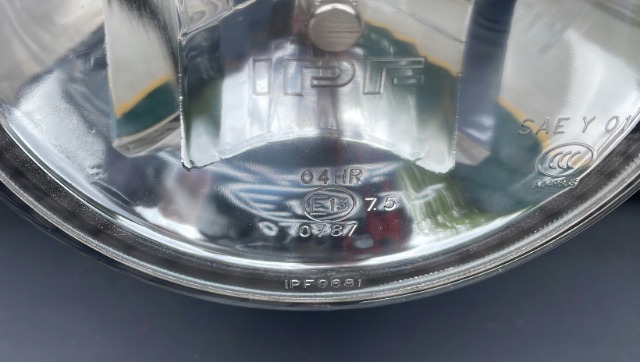

Are these add-on driving lights? That's what isn't clear.

I am not sure if Portugal is the same as the UK, but in the UK unless the lights you have were originally fitted with LEDs, you can't legally fit LEDs in place of the halogen bulbs and still be road legal, it doesn't matter if they are E marked or not.
@ rogerzilla
Portugal. As I see it, so far this is an international forum.
You've misread me, IPF 968 lights are H3 one filament only.
I've wired them to be on with high beam only, which is legal if lights are marked "HR" (and "E", obviously)
It's crazy I know, if the beam pattern is the same and the light output the same (or within limits) then why not, but that is the current UK regs.
A lot of people fit LEDs and then swap back to halogen for the road worthy test (MOT).
Robin
