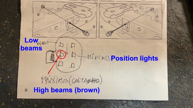

The rule of thumb for us is it's admissible to have 4 high beams and 2 low beams + 2 fogs.
So, my IPF's relay is wired to the high beam's brown cable as per my humble sketch (maybe it'll save someone some time...)
I should,'t be running the fogs with high beams + IPFs, but it's a great way to drive on my farm at night.

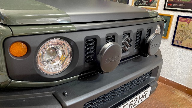

You would get away with it here as well since they are additional lights and the MOT tester wouldn’t switch them on during the test as they only have to test the statutory lights. Even better, leave the covers on for the test.
Finally you could claim they are for off road use only and that is perfectly legal here.
They look really good on the front of your Jimny.
