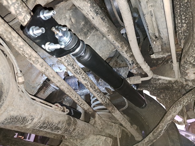

Bushes, Bracket & Damper all here, just need to get some time to have a go at fitting, intended to do the bushes first, but not looking forward to fighting the old ones, so may leave that till I know I can get into a friends garage to use his press.
Is there any adjustment on the steering box, I was looking yesterday there looks to be a little play from turning the wheel before the arm moves coming out of the box, but it's very difficult on your own to be at both ends at once. Seem to remember back in the 70's being able to add a little more preload to take up some of the slack.

22 Dec 2023 19:55 #253014 by Phaeton
Replied by Phaeton on topic Re:Re:Wandering on the Road
Had a spare hour this afternoon before it went too dark, have to do everything outside no garage, but all went really well all sorted within the hour from going out to coming back in. Went straight on no hassles at all, only thing I did change in the kit was to replace the 8mm nuts with some nylocks
