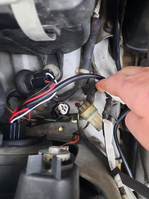

I'm trying to wire in fog lights, but the ones I bought don't come with any wiring or harnesses. Am I going to be looking for something to connect to the plug in the attached photo? I have one behind each headlight.

I do not know the year or type of your Jimny. My Jimny had all the wires pre-installed and hanging loose, a little hidden. So it was just plug & play, also for the switch.

just remember jimnys are negative switching
