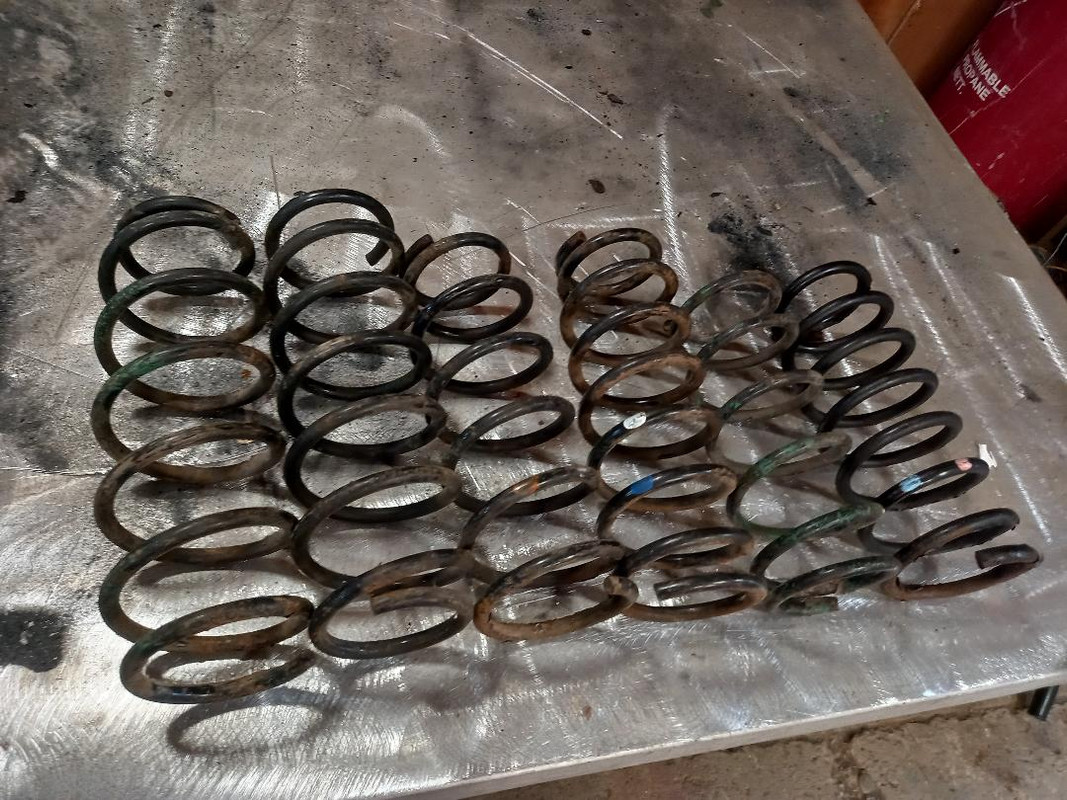

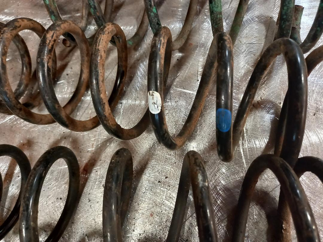

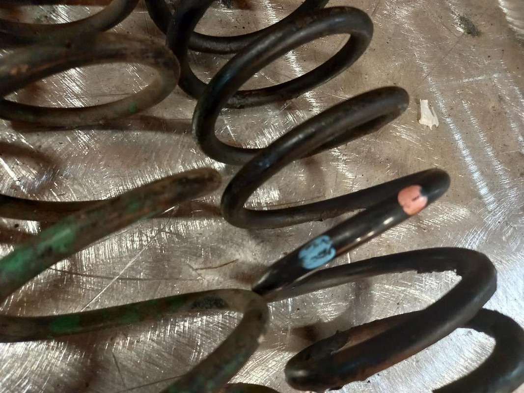

hi    does anyone know the colour coding for the road springs on a standard jimny , ive hunted round the shed and found 10 different springs  in 3 different lengths oddly      they are coded with 2 colours on each  so they are position spercific   anyone know which goes where ?
[img
[img
[img
thanks Andy

04 Sep 2021 05:48 #238200 by Lambert
Replied by Lambert on topic Re:road spring position
Don't know the colours off hand but the shorter ones go in the back, then the middle one goes near side front and the long one is off side front. That said all springs fit in all positions and putting a pair of medium fronts in the back will make it look less Carolina Squat.
