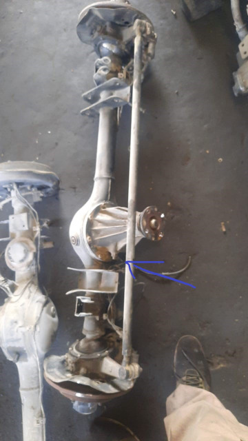

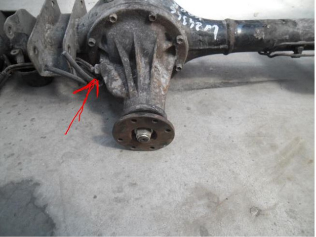

Hello, so I bought a new pair of diff for my 2016 jimny in order to change ratio. I supposedly got those from a 2010 and up jimny jb23.But something is bugging me and I couldn't manage to find it on google so what is this thing buldging from the side of the third-member?
PS: this is not the actual diff it is a picture from google that was clearer than the pics I have from my diff
PPS: Of course the front diff on my jimny don't have this that's why I'm asking.

18 Jun 2021 19:29 #235940
Replied by mlines on topic Re:What's this thing buldging from the side
It's called a "gear thrust bolt".
I assume it preloads part of the differential gearing
Sent from my moto g(
power using Tapatalk

- ZblackliZard
18 Jun 2021 19:34 #235941
by ZblackliZard
Replied by ZblackliZard on topic Re:What's this thing buldging from the side
thank you, any idea why would it be present in this third-member but not the one on my car?
18 Jun 2021 19:44 #235942
Replied by mlines on topic Re:Re:What's this thing buldging from the side
Looking at the parts manuals I have I can see them on all models up to around 2009. I don't have information after that date
- ZblackliZard
18 Jun 2021 19:47 #235943
by ZblackliZard
Replied by ZblackliZard on topic Re:Re:What's this thing buldging from the side
thank you for your help the diffs in the picture are jdm specific that may be why.
If those manuals are digital you think you could share them they could really come in handy
