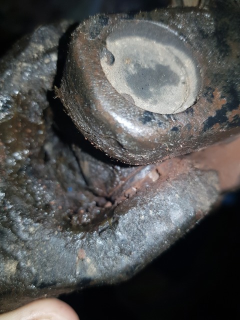

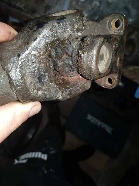

So stripped it down today halfshaft look ok however rear prop uj has shot needle bearings out so I will replace them and hopefully that's that sorted .
Can anyone confirm if a QL102 universal joint will fit ? Measurements are correct
QL15002 is same measurements however it's a sealed unit .
Thanks Sam
Thanks Sam

lt's not a good thing to do in a Jimny for the reasons mentioned already.
However if everything else on the transmission is still working on the vehicle apart from that universal joint, you most likely got away with it.
Change to 2wd and carry on.
